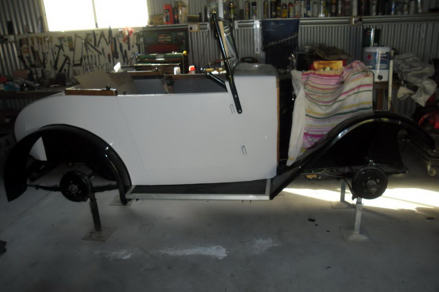

Latest pics of Y329 from Ewan.
He reports: "Y329 painted, we are having a heat wave with day temps in the high 30's which meant an early start as temp in the shed was in the low 40's by midday, front guards have been painted black and ready to bolt up."

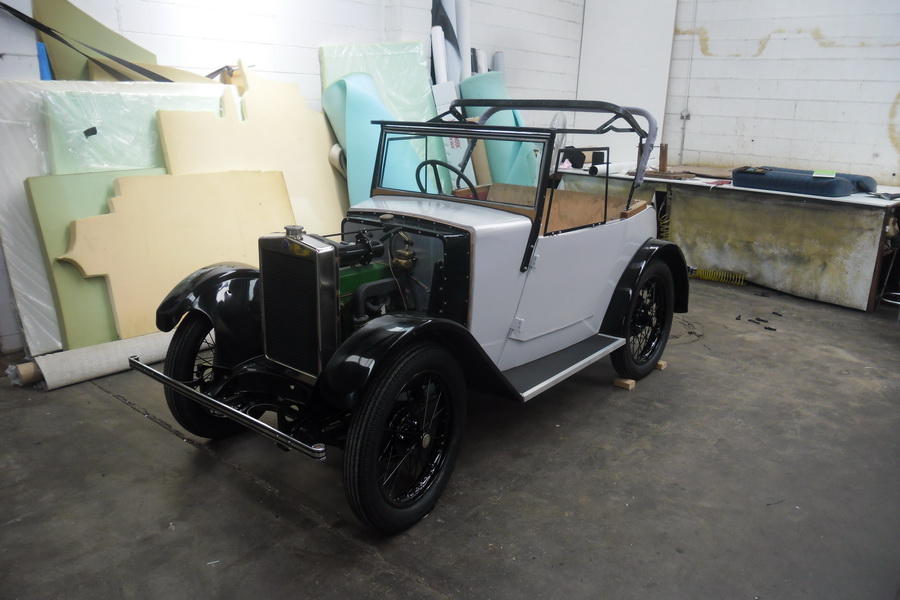

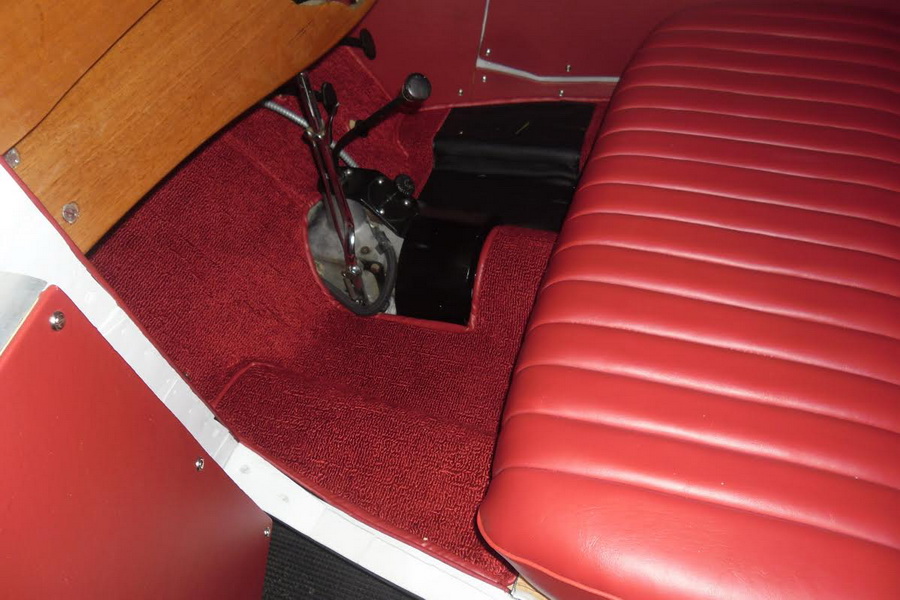

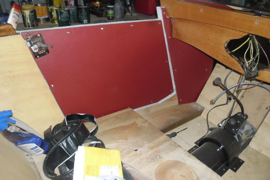

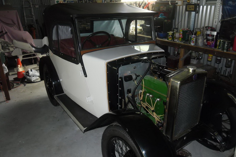

Thanks Ian for posting the photos for me, Fitted 4 new tyres last week and have booked it in for seats and hood to be made early Jan. Have had two bumper bars made with two grooves milled into them then had the ends rolled and they are at the platers now.
Ewan

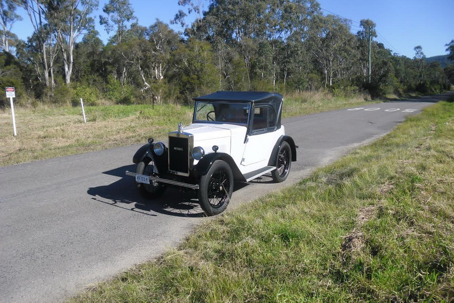

The time had come to fire up. Oil filter primed, plugs out, cranking over, no oil pressure. Off with the pump and filter (made one good pump out of four). Still no pressure. Off with the pump and sump. By squirting oil into the gallery oil was coming out the rear main as quickly as it was going in. I had some new M Type gears that I had bought from S&V many years ago. These are a lot wider than Minor gears so thought more volume might help. M Type gears need an adapter plate which had come with the kit. It would not fit over the gears, so had to grind out. Thought that was pretty average. Pump back on, now have 15 psi. Still not enough, so off with flywheel and bell housing. Rear main flogged out. Found a good bell housing and fitted a lightened flywheel that I had. Back together, pressure now 60 psi. That will have to do as I have been chasing my tail for four days. So carby flooded, ignition on, full choke, heart in mouth and she fired into life. After sitting in a paddock cut in half for 65 years, it lives again.

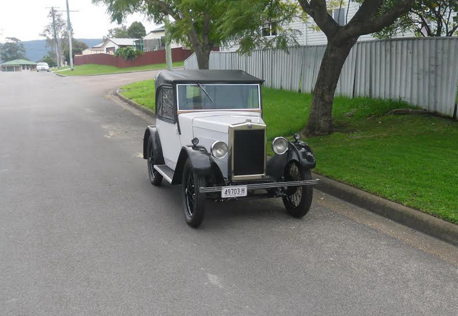

Took M24068 (46879H), which turned 85 this month on a club run and up turned the ex Gary Shulze car now in the ownership of Andrew Stewart of Yarrauel NSW. Andrew is also in the progress of rebuilding two other cammy Minors. Andrew plans to join the register.
